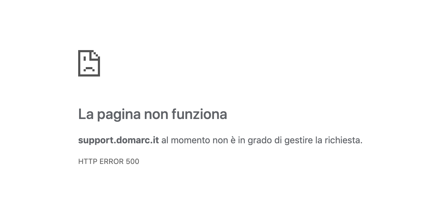

      but when i try to save config of theme modification i GOT a
      <hr />
      La pagina non funziona<br />
      supporto.domarc.it al momento non è in grado di gestire la richiesta.
      HTTP ERROR 500

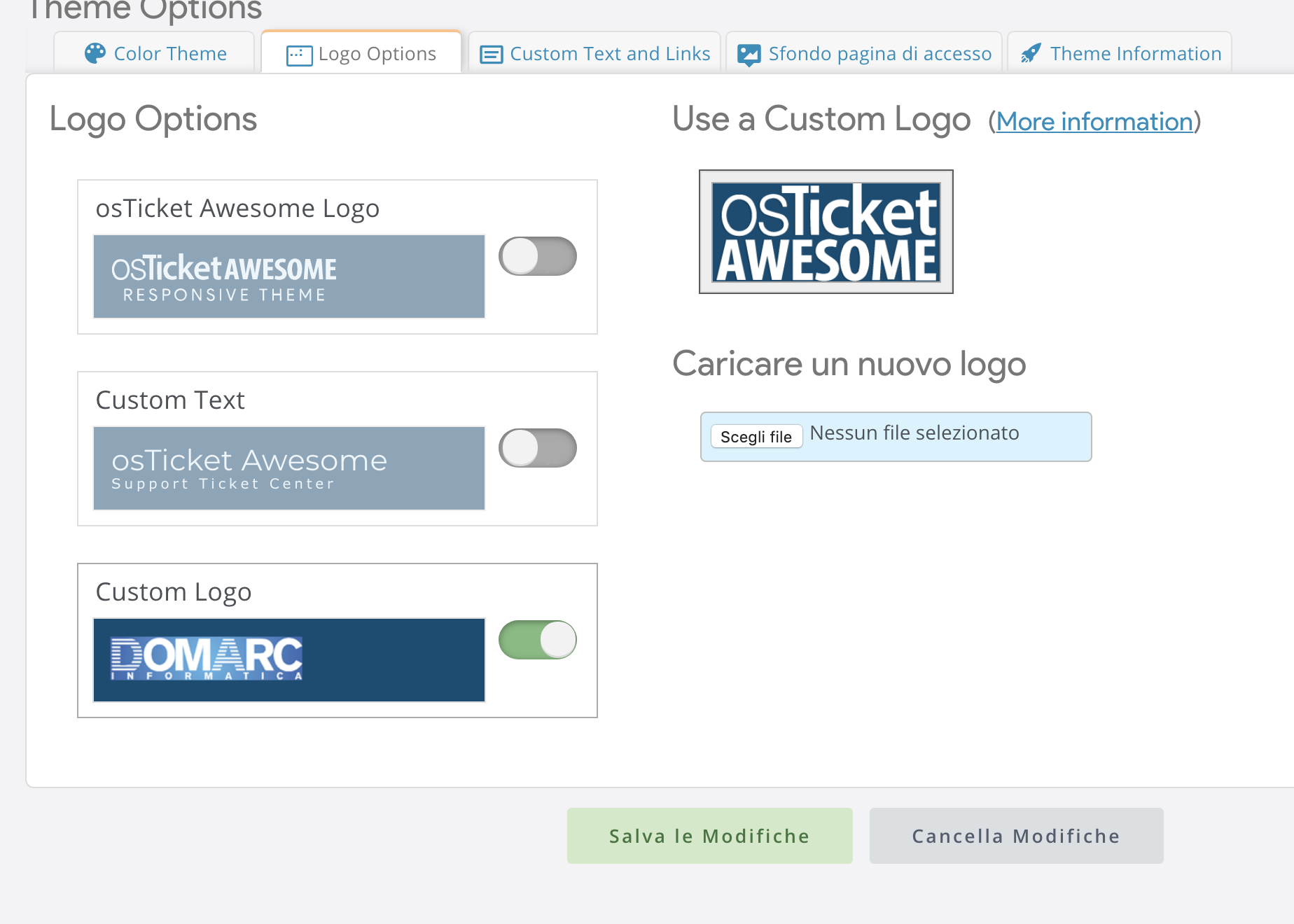

      theme is working, as first installation
      but is not possible to change any configuration like logo, colors, background
      when i try to save options, i got error 500 in web site
      file permission are ok
